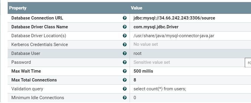

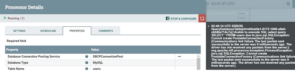

I am having issues while connecting to mysql database using apache nifi.  The error is as follows
Cannot create PoolableConnectionFactory
Please note that Apache Nifi and MySQL is installed on the same Linux server and hence there shouldn't be any problems with the 2 applications talking to each other.
The database connection pool settings is provided below
The error when I try extracting the records is provided below

Hi All ,
I fixed this by changing the source URL to  jdbc:mysql://127.0.0.1:3306/source .
I still need to understand the reason as to why it works this way when both the applications are installed on the same linux box . Also to note that in my case I have this linux installed on a VM on Google Cloud Platform
I will work on it and post the reasoning for reference.

@abhinav_joshi  its related to permissions for root user.  First, you should avoid root user.  Also recommend use FQDNs, not ips.   It seems that user has perms on the localhost ip, but maybe not when connecting from the external IP.    If you make a specific user, you would need to grant them access to a database from a specific host.  For example:
CREATE DATABASE hive;
CREATE USER 'hive'@'hdp3.cloudera.com' IDENTIFIED BY 'hive';
GRANT ALL PRIVILEGES ON *.* TO 'hive'@'hdp3.cloudera.com' WITH GRANT OPTION;
FLUSH PRIVILEGES;
