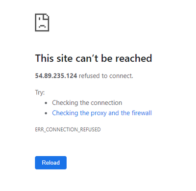

Hi,
 I deleted this file in my ubuntu ec2 instance :
1.content_repository
2.database_repository
3.flowfile_repository
4.provenance_repository
and also delete file in conf ->  flow.xml.gz
after the deleting this files in my ubuntu ec2 instance i will restart nifi.sh after that the nifi is runing but i will open my ip address in chrome http://54.89.235.124:8443/ i am getting this site cann't reached error.

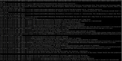

in my putty i am getting like this
please help to resolve this issue
