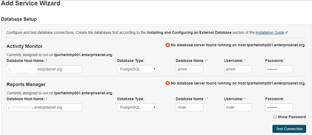

Actually after deleting the CMS i am not finding the logs to attach, And as you suggested i have already created and trying to test the connections using those credentials.
But i am getting error and you can see it in screen shot.

The "No database server found running" indicates that your postgres server is either not running on the host you specified or is running on another host. If you don't know where your database server is or it is missing, make sure you know if you installed and configured your own database or if you are using the "embedded" database from Cloudera that is intended for Proof of Concept installs.
If you need to set up your databases again, you can use this:
https://www.cloudera.com/documentation/enterprise/latest/topics/cm_ig_extrnl_pstgrs.html
After preparing the database, you can retry the install.
NOTE: If you are *not* using MapReduce1 then you do not need Activity Monitor as it does not capture MR2/YARN. If you are only using YARN for your Map Reduce, then this is a good time to get rid of Activity Monitor.

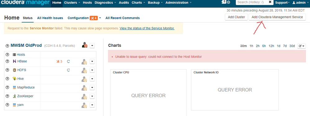

And you can find my present cluster health and i mentioned there the arrow mark, from there i am trying to add the cloudera management services.

Thank you for all that information. It really helps us understand the problem.
When you are specifying the database host, I note in your image that you specified just the host which means it will default to using the default postgres port (5432). The port for the embedded db is "7432".
Try specifying your database host with "host:7432" (including the port) to see if that helps.
Since you are using the embedded database, the usernames and passwords will be created for you.
To use the existing embedded database, you will need to use the generated username and passwords that are stored for reference in the following file:
/etc/cloudera-scm-server/db.mgmt.properties
You can use the username and password specified for each database.
Based on what you mentioned, the above are likely to help.

Team,
Any solutions will be appreciated.
Still am facing the same issue and can some one help me on this.
Thanks,
Vinod

Since Reports Manager and Activity Monitor are not as essential as Host Monitor, Service Monitor, Events Server, and Alerts Publisher, I recommend adding the Management Service with only those for now.
They don't use a SQL database, so you should be able to get your CM and Management Service looking good again. You can then add the Activity Monitor and Reports Manager later without as much stress.
REGARDING THE PROBLEM:
I'd like to point out that the error you got in the wizard (when you took the screen shot) showed that the host/port combination provided in the Add Service wizard could not be contacted. The "No database server found running on host ___" error is thrown if a CONNECTION REFUSED is returned by the attempt to connect. This generally means that there was nothing listening on the requested host and port.
Since we found no port number (7432) specified in the database host string (in the Add Service wizard) the default of 5432 would be used. NOTE that you have 2 postgres servers running on the host where you did the netstat:
- Cloudera Embedded (listening on 7432)
- Another postgres server (listening on 5432)
If that is the case and the "test connection" could connect to neither, that makes me curious whether the hostname specified in the wizard is the one where the postgres servers are listening.
We understand that you are under some stress, but it is very difficult to understand what is going wrong with just the information we have. It might be useful to take a look at the stderr.log and stdout.log for the test connection command.
On the host where you are attempting to install the Reports Manager and Activity Monitor, you can look in the /var/run/cloudera-scm-agent/process directory to find the db test command process directory. It sill look like this for instance: 2839-MGMT.ACTIVITYMONITOR-test-db-connection.
Inside it, you will find a logs directory containing stderr.log... you might go over that file and see if there are any other clues.
Also, you could use psql command to test the connection yourself from the host where you are trying add the Reports Manager and Activity Monitor.
