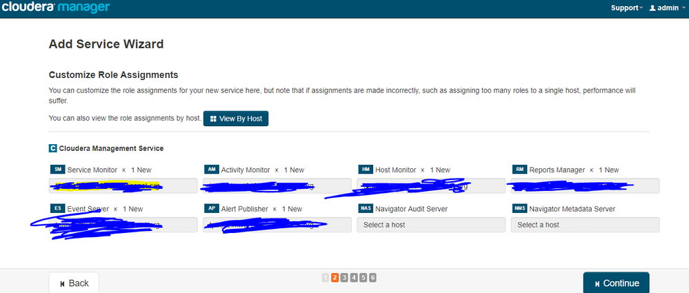

Hello Team,
All of sudden service monitor was went down and when i checked the logs i can see connection refused error in logs.
I have tried to restart all the CMS services and this time all went down.
What i was did is i have deleted CMS and trying to re-add the CMS to cloudera manager,
This time i am not able to add the CMS and when i am trying to adding it active monitor and reports manager cant able to find databases and DB's in test connection stage.
Can some one please respond ASAP and it would be greatfull.
