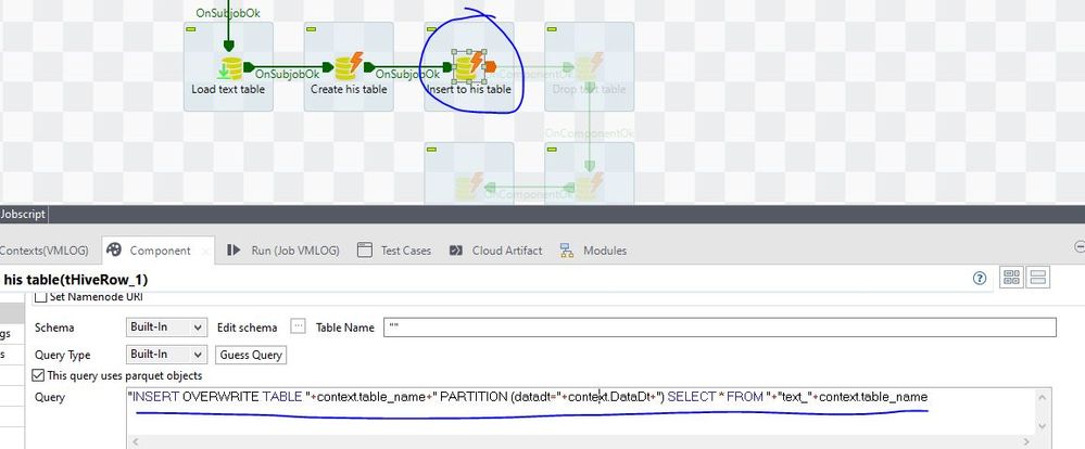

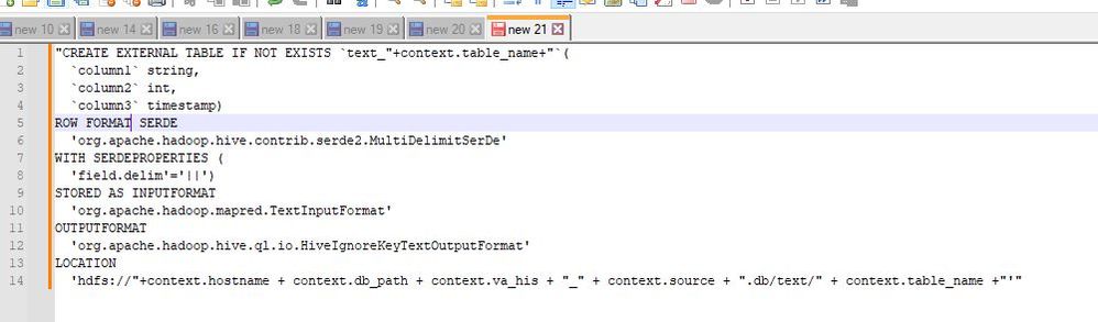

Hi,
After Multi Delimiter Issue is solved. I got an error with data insertion.
So, after the data successfully inserted to text file format table with rowserde hive.contrib.serde2.MultiDelimitSerDe. Then i need to insert those data to parquet format table.
But when i ran the query to insert data, it failed.

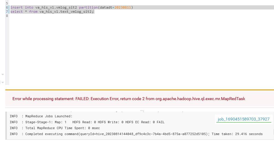

Error message: "[FATAL] 10:25:08 vaproject.xxx tHiveRow_1 Error while processing statement: FAILED: Execution Error, return code 2 from org.apache.hadoop.hive.ql.exec.mr.MapRedTask".
I used this script:
"INSERT OVERWRITE TABLE ParquetTable PARTITION (datadt=dateint) SELECT * FROM TextFileTable"
What is wrong or what am i missing? Please need your help. Thank you.

Sorry took a long time to reply,
I couldn't find that application_id anymore. So i try new task, just simply data insertion query with application_id = application_1690451589703_37927
In log file i think i found the error. It is written
"Caused by: java.lang.RuntimeException: Map operator initialization failed
at org.apache.hadoop.hive.ql.exec.mr.ExecMapper.configure(ExecMapper.java:137)
... 22 more
Caused by: org.apache.hadoop.hive.ql.metadata.HiveException: java.lang.ClassNotFoundException: Class org.apache.hadoop.hive.contrib.serde2.MultiDelimitSerDe not found
at org.apache.hadoop.hive.ql.exec.MapOperator.getConvertedOI(MapOperator.java:326)
at org.apache.hadoop.hive.ql.exec.MapOperator.setChildren(MapOperator.java:361)
at org.apache.hadoop.hive.ql.exec.mr.ExecMapper.configure(ExecMapper.java:106)
... 22 more
Caused by: java.lang.ClassNotFoundException: Class org.apache.hadoop.hive.contrib.serde2.MultiDelimitSerDe not found
at org.apache.hadoop.conf.Configuration.getClassByName(Configuration.java:2409)
at org.apache.hadoop.hive.ql.plan.PartitionDesc.getDeserializer(PartitionDesc.java:170)
at org.apache.hadoop.hive.ql.exec.MapOperator.getConvertedOI(MapOperator.java:292)
... 24 more
2023-08-14 14:41:08,061 INFO [IPC Server handler 11 on 42850] org.apache.hadoop.mapred.TaskAttemptListenerImpl: Diagnostics report from attempt_1690451589703_37927_m_000000_1: Error: java.lang.RuntimeException: Error in configuring object
at org.apache.hadoop.util.ReflectionUtils.setJobConf(ReflectionUtils.java:113)
at org.apache.hadoop.util.ReflectionUtils.setConf(ReflectionUtils.java:79)
at org.apache.hadoop.util.ReflectionUtils.newInstance(ReflectionUtils.java:137)
at org.apache.hadoop.mapred.MapTask.runOldMapper(MapTask.java:462)
at org.apache.hadoop.mapred.MapTask.run(MapTask.java:349)
at org.apache.hadoop.mapred.YarnChild$2.run(YarnChild.java:174)
at java.security.AccessController.doPrivileged(Native Method)
at javax.security.auth.Subject.doAs(Subject.java:422)
at org.apache.hadoop.security.UserGroupInformation.doAs(UserGroupInformation.java:1731)
at org.apache.hadoop.mapred.YarnChild.main(YarnChild.java:168)
Caused by: java.lang.reflect.InvocationTargetException
at sun.reflect.NativeMethodAccessorImpl.invoke0(Native Method)
at sun.reflect.NativeMethodAccessorImpl.invoke(NativeMethodAccessorImpl.java:62)
at sun.reflect.DelegatingMethodAccessorImpl.invoke(DelegatingMethodAccessorImpl.java:43)
at java.lang.reflect.Method.invoke(Method.java:498)
at org.apache.hadoop.util.ReflectionUtils.setJobConf(ReflectionUtils.java:110)
... 9 more
Caused by: java.lang.RuntimeException: Error in configuring object
at org.apache.hadoop.mapred.MapRunner.configure(MapRunner.java:38)
... 14 more
... 17 more
... 22 more
... 22 more
... 24 more"
Sorry i cant share the log file.
