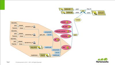

@Francisco Pires
Typically, for data warehousing, we recommend logically organizing your data into tiers for processing.
The physical organization is a little different for everyone, but here is an example for Hive:
