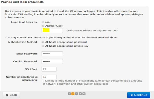

Explorer
where you are getting the error? paste the screenshot please...

Explorer
Hi, I am using CDH 5.4.3 vm to install cloudera manager. But while installing through web console(localhost:7180) I am facing the following error 2016-09-03 09:59:12,012 WARN NodeConfiguratorThread-5-0:com.cloudera.server.cmf.node.NodeConfigurator: Could not authenticate to localhost net.schmizz.sshj.userauth.UserAuthException: Exhausted available authentication methods at net.schmizz.sshj.SSHClient.auth(SSHClient.java:232) at net.schmizz.sshj.SSHClient.auth(SSHClient.java:208) at com.cloudera.server.cmf.node.NodeConfigurator.connect(NodeConfigurator.java:341) at com.cloudera.server.cmf.node.NodeConfigurator.configure(NodeConfigurator.java:889) at com.cloudera.server.cmf.node.NodeConfigurator.run(NodeConfigurator.java:935) at java.util.concurrent.Executors$RunnableAdapter.call(Executors.java:471) at java.util.concurrent.FutureTask.run(FutureTask.java:262) at java.util.concurrent.ThreadPoolExecutor.runWorker(ThreadPoolExecutor.java:1145) at java.util.concurrent.ThreadPoolExecutor$Worker.run(ThreadPoolExecutor.java:615) at java.lang.Thread.run(Thread.java:745) In my centos vm I do not have any file named 10-perfmgmt under /etc/sudoers.d. So I created one file and add the following lines root ALL=(ALL:ALL) ALL %admin ALL=(ALL) ALL %sudo ALL=(ALL:ALL) ALL userid ALL=(ALL)NOPASSWD:ALL Now my question is, what user id should I write here in order to avoid the error. I am using a vm player and logging as 'training' here. My superuser is 'root'. Why am I getting this error, what is the actual solution for it. Please help me onthis.
