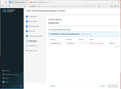

Faild to authenticate at Install Agents step
Explorer
I am setting up a stand-alone CDP cluster. However, getting errors when doing the agents installation steps.
I have used this command but it still error:

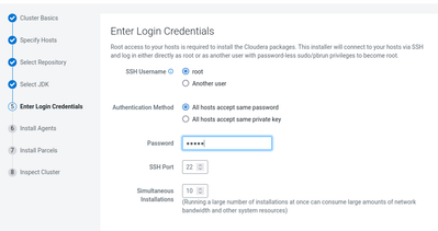

The problem is solved.
Follow the below steps to fix it.
sudo nano /etc/ssh/sshd_config
In the file now look for PermitRootLogin without-password and replace it with this
PermitRootLogin yes
Now restart the ssh service
sudo service ssh restart
retry the installation and it should work.
