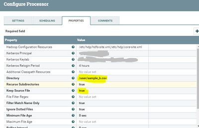

@Pallavi Ab
once make sure your file is in the directory and Nifi has permissions to the directory.
I am not sure about your get hdfs configurations, take a look on the below configs and configure your processor same configs in the screenshot shown below.
Configs:-
Important Property is Keep source file configure this property as per your needs.
Keep Source Filefalse
  • true
  • false
Determines whether to delete the file from HDFS after it has been successfully transferred. If true, the file will be fetched repeatedly. This is intended for testing only.
@Shu
Thank you for quick response...I made the changes as suggested by you but now the processor is failing with below error:
Caused by: java.io.IOException: PropertyDescriptor PropertyDescriptor[Directory] has invalid value /user/cmor/kinetica/files/sample_b.csv. The directory does not exist.
Here is how the configuration of the processor looks:

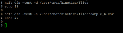

@Shu
This is what I see after running the commands
