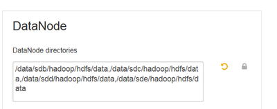

Created on ‎09-05-2018 03:02 PM - edited ‎08-18-2019 02:04 AM
- Mark as New
- Bookmark
- Subscribe
- Mute
- Subscribe to RSS Feed
- Permalink
we configured 4 disk! , it is not the first time that we configured , and this is the same on all our lab cluster ,
please look on this , you can see clearly 4 disks !
Created ‎09-05-2018 03:16 PM
- Mark as New
- Bookmark
- Subscribe
- Mute
- Permalink
Did you restarted HDFS after adding disks?
It's hard to tell you exact cause without analysis namenode and datanode log.
If possible attach namenode and one of the datanode log which must be after service restart. We can validate the disk registration in HDFS.
Also /etc/hadoop/conf.
