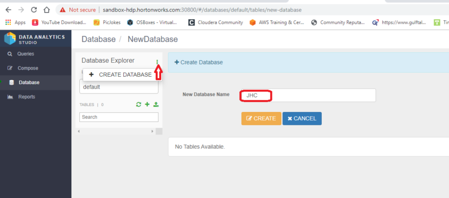

Now to demonstrate I will create a new database  JHC using DAS as the default user hive [See Create DB with DAS],Create DB in DAS.PNG
 You will see warning waiting for the database to be created it should succeed and now it should be available in the drop-down list see   [JHC database]

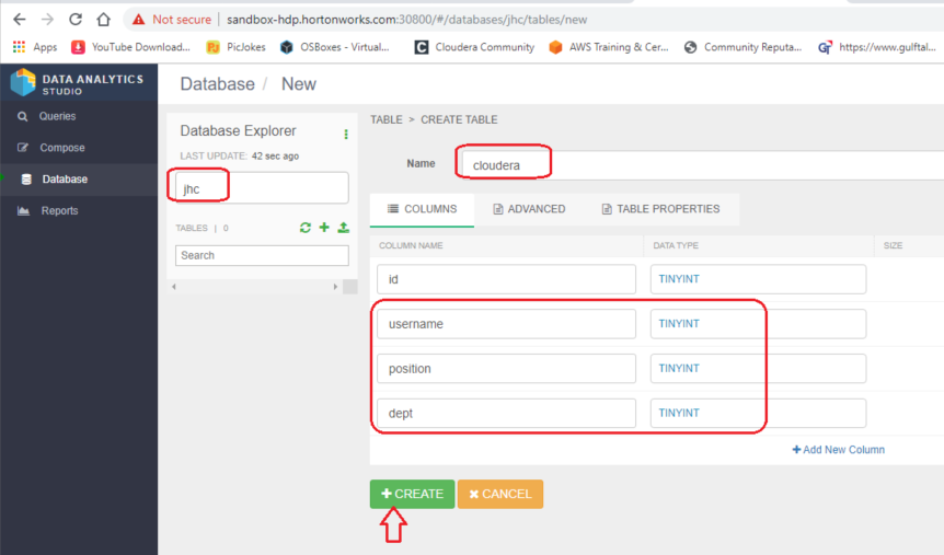

 Now choose this database to populate it with tables sample table Cloudera [see create_table_cloudera]

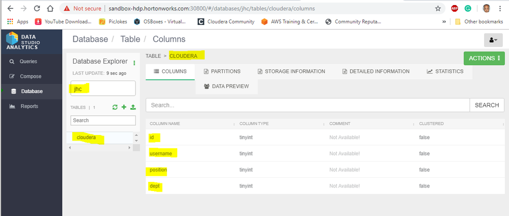

The DAS view should update with the table  [cloudera ] in [ jhc] database

DAS view now shows the new table Cloudera in JHC database. Now getting back to your question  "When you query the databases the table doesn't appear in the drop-down list " Are you sure you selected the same DB where you created the table?"

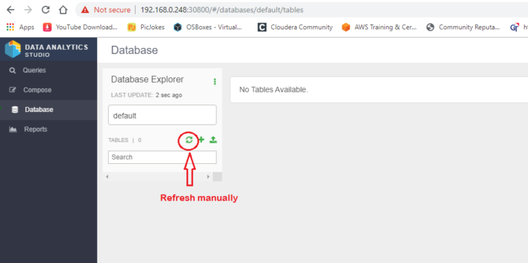

I realized I had to wait for the refresh maybe you should manually refresh 🙂

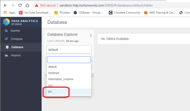

As you suggest, I created a new database called JHC. The query succeeds, and appears in the query log:
However, when I click the database dropdown, the new database is not listed:
Note that I am using the Docker version of HDP 3.0 sandbox.
Please advise.

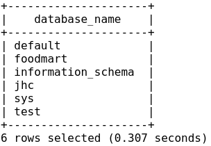

Logging in as hive user on the shell, the new database is listed, but not shown on DAS.

I noted the database refresh took very long , did you manually refresh please do that and update this thread
