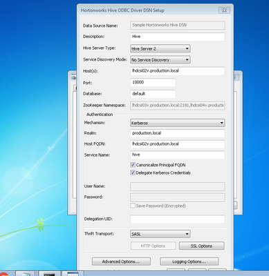

i dont have SASL enabled so i am using http to connect , can you please take a look at the screenshots and see what i am doing wrong ?
1- in the port what should i use? 10000 , 10001 or 9083 ?
2- the username and password is the ambari login username/password or an hive username?
also which of the ports should be open between client and hive server ?

ok I am using binary mode so I will use port 10000. its currently blocked so have to ask security guys to open it.
the hive.server2.authentication is not set but I see the two other similar variables . so for authentication method I would just choose "username" and not "username/password" ? where would I create this user?
we are not using Kerberos.

@Chiran Ravani, @Jay Kumar SenSharma , @Geoffrey Shelton Okot , @Vipin Rathor @Neeraj Sabharwal i am also facing the issue while setting up the Hive ODBC DSN connection.
Error:-
Logs attached logs.txt
[Hortonworks][DriverSupport] (1170) Unexpected response received from server.
Please ensure the server host and port specified for the connection are correct.
Ambari host is SSL enable.
And using MIT kerberos.
HDP 2.6.5
Hive ODBC DSN 64 bit
Please help.
