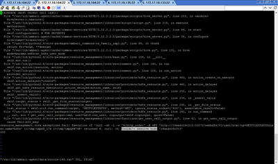

While starting Hiveserver2 in apache ambari, I'm getting "Couldn't resolve host" issue.
My ambari setup is a docker image having 3 clusters.
I can see that, as part to resolve the host it is taking the docker container name followed by the port no. I completely doubt if that is going to work.
http://16aadcc9c315:50070 not sure why it is like this.
16aadcc9c315 is the name of one of my cluster which is a docker image.
Any input on this will be appreciable?
Below is the error in logs file:
