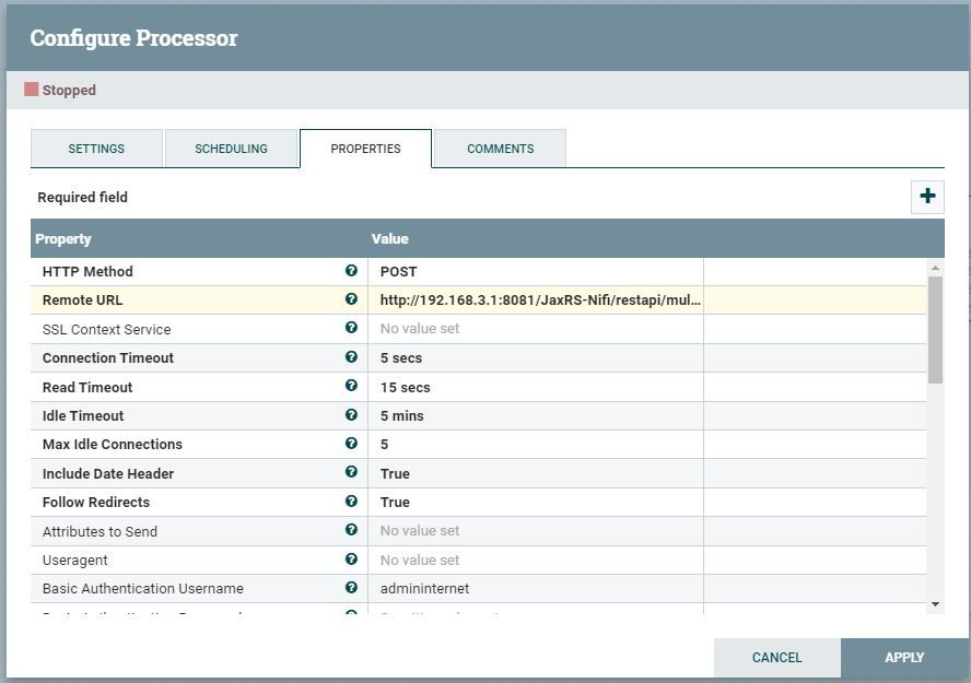

  • Inside the NiFi setup, I get a file from a local directory and I invoke a HTTP POST to send over to the second machine which hit the Wildfly Restful Webservice endpoint. Below image show the configuration I have done inside the Invoke HTTP:
(Note: the Remote URL: http://192.168.3.1:8081/JaxRS-Nifi/restapi/multipart/upload )

I am not sure how large your multi-part form data is that your are trying to post to you endpoint is, but your timeout values are very aggressive at 5 sec and 15 sec.
Have you tried sending these values to more common 30 sec?

I am sending a 1kb file over the rest endpoint of a different IP machine. What I am asking here is how do I configure the invokeHTTP request using IP address?
Example: Machine 1 (192.168.4.1)  which contain NiFi (GetFile processor --> invokeHTTP processor) to Machine 2 (192.168.3.1) which contain the Wildfly restful webservice.
Thanks.
