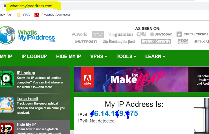

If you are not a network expert the best would be to lock the inbound port rules  with source *  and Destination * to your IP which you can get from the URL www.whatismyipaddress.com
