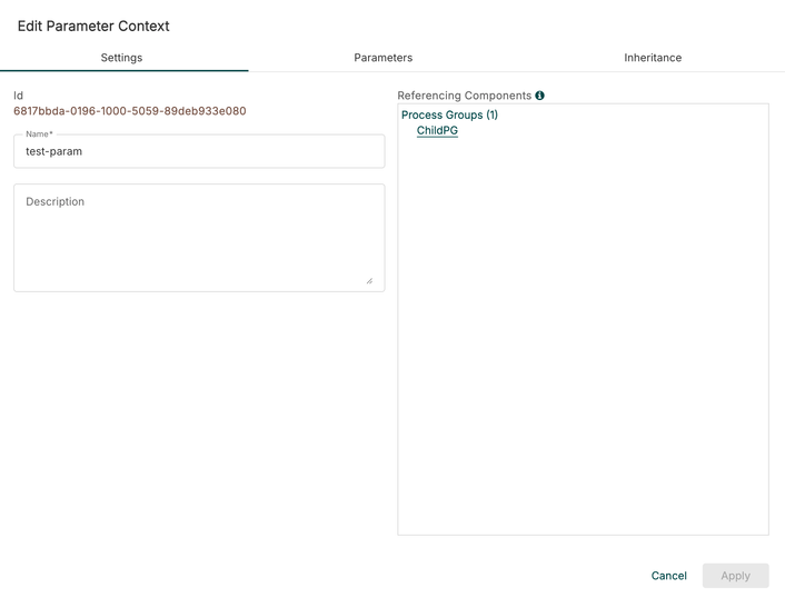

From within the "Parameter Contexts" UI, select the parameter context used by Process group and select "edit" from 3 dot menu to far right.  Will open UI that looks like this:

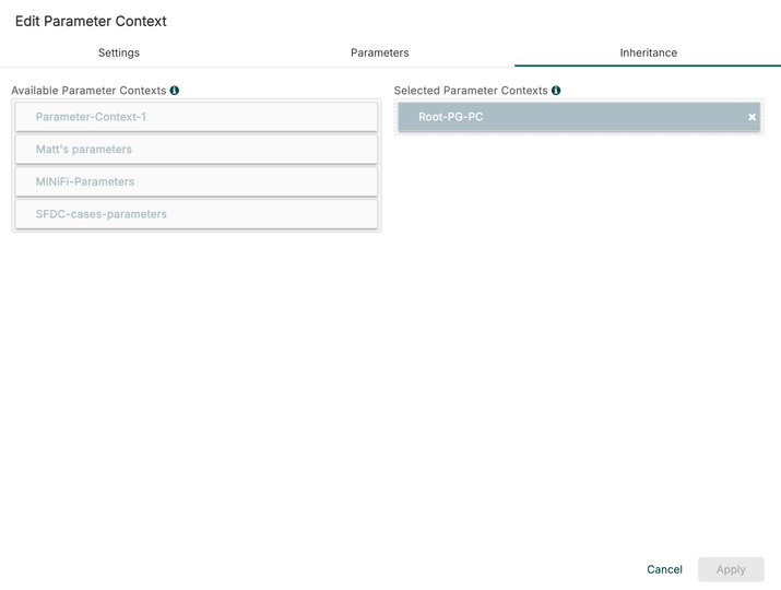

Select the "Inheritance" tab along the top of this UI.  Drag and drop any of the Available Parameter Contexts form the left-hand side to the "selected Parameter Contexts" list on the right-had side.  The order in which the Selected Parameter Contexts are ordered in the list is important.  The top most takes precedence over those below it.
So above shows an example where my "test-param" parameter context is inheriting parameters from the "Root-PG-PC" parameter context.
So lets say you have an identical parameter "name" defined in multiple selected parameter contexts.   The one defined directly on the PG assigned Parameter context is used.  If parameter by that name does not exist there its starts searching inherited parameter contexts from top down.  First match found is used.
