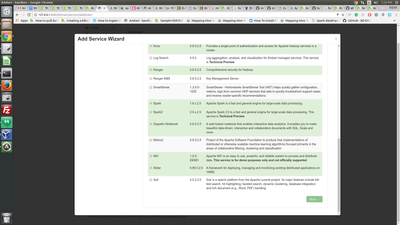

I using HDP 2.5 and I add a NIFI service in it, I need to send a data to Elasticsearch 5.X, when i add a processor in NIFI, the putelasticsearch5 processor is missing but it has only putelasticsearch(it supports only elasticsearc 2.X version).How can I add the Putelasticsearch5 processor in nifi.
