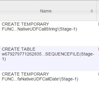

How do i get the complete hive query , when resource manager shows only this much in the UI?

You should be able to see the query in the HiveServer log or a Hive-related UI, like Hive View for Ambari or Hue (there should be a query history). The Resourcemanager does not show the full query, because the job is only named after a partial of the query. Why only a partial? Some queries can be quite large and Job Name is limited in regards to the allowed #characters.

You can look into the Tez UI in Ambari or in the hiveserver2 log. The query is not in yarn.
