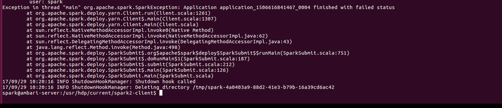

I'm trying to run this command ./bin/spark-submit --class org.apache.spark.examples.SparkPi --master yarn-cluster --deploy-mode cluster --driver-memory 512m --executor-memory 1g --executor-cores 4 --queue default examples/jars/spark-examples*.jar 10in the directory /usr/hdp/current/spark2-client with spark user.
I got the error log mentioned in "log.png".
How can i fix this issue ?

Hi @raouia ,
Can you please look at the Yarn Application log(application_XXX_XXX) which will have the detailed information about the root cause for the failure.
on the other hand, from the symptom, Looks something to do with library Configuration , con you please ensure, when you add the additional node, all the spark libraries are available on that node too.
Hope This Helps !!

I've explained the logs i got in the following link
so, how can i fix this problem?

Hi @raouia,
The error mentioned that unknown host exception (ambari-agent1/2), which means the nodes can't be discovered with that name.
if you don't have fully qualified domain name with DNS, you can update your /etc/hosts file with respective IP address, so that that can be discovered.
that implies your /etc/hosts file can be appended with
<ip of ambari-agent1> amabir-agent1
<ip of ambari-agent2> amabir-agent2
in all the hosts so that every one can be discover other hosts.
