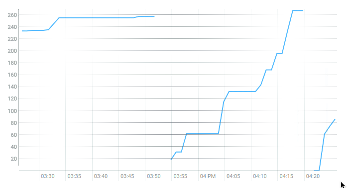

This is the behavior of the #of regions for the regionserver that dies: it dies here 2x and the number of regions collapses as they are moved.
2 failures of regionserver at 3.54 and 4.15, followed by copying of regions

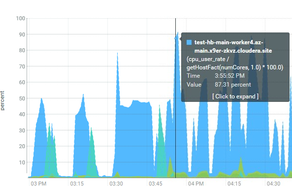

The cpu looks as follows (looks ok to me):

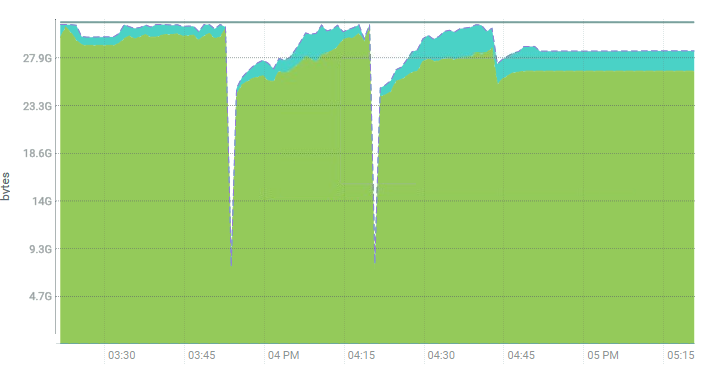

The memory looks like it comes close to the max available:
--> Maybe it fails because of memory? Like that all writes are first written to memory and the available memory has been used up? But I had expected to see this kind of error message somewhere (logs or cloudera manager).

I would like to add that the reason for the observed behaviour was an overcommit of the memory.
While I am writing, the memory used of the box at some point comes so close to the maximum available on the regionservers, that the problems start. In my example at the start of writing I use about 24/31GB on the regionserver, and after a while this becomes > 30GB/31GB and eventually failures start.
I had to take a way a bit of memory from both the offheap bucketcache and a bit of the regionserver's memory. Then the process starts with 17GB/31GB used, and after writing for an hour it maxes at about 27GB, but the failure was not observed anymore.
