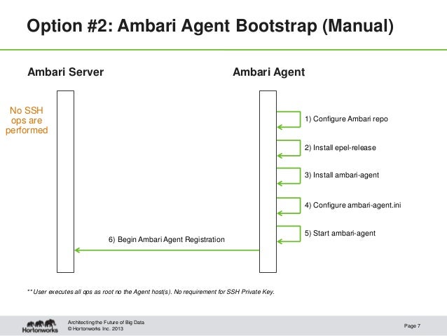

@Wael Emam It may be possible to do it. You would have to be very creative. See this
http://image.slidesharecdn.com/ambari-agent-registration-flow-130308115303-phpapp02/95/ambari-agent-...
