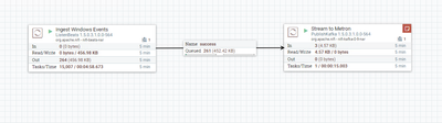

I Installed winlogbeats on Windows workstation with below config :
output.logstash:
  hosts: ["nifi.node.srv:5098"]
and I use this nifi processors to stream event to metron
listenbeats config :
Publishkafka cofig :
Nifi Data provenance in publishkafka processor :
and I create sensor in Management UI with logstash parser and winlogtop topic ( kafka) . now I can't see any log data in alert UI . what's problem ?
Thanks
Rising Star
Hi @haco fayik
That looks great. Sounds like you got around the initial problem of ingesting data into Metron.
There could be multiple reasons, e.g. parser, enrichment and indexing topologies not running or being misconfigured.
Would you create a new question for this and provide more details, such as worker logs of those topologies?
