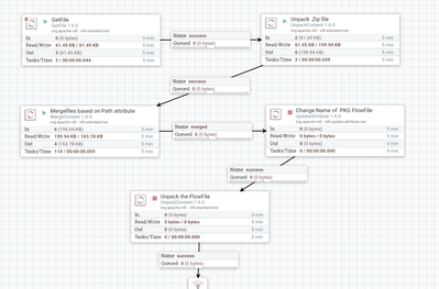

Sample Flow:-
Reference flow.xml 191223-uncompress.xml

@Shu Thanks for the response.I tried changing the path attribute by providing it with test/test_folder.I used update attribute I coulde see that the initial path was '/'.After Update attribute it changed to test/test_folder.But the unpack still goes to failure condition.It gives an an unsupported zip feature extension and descriptor not supported.

If you are still having issues please attach the flow and config of processors screenshots, it will be helpful to find root cause.
