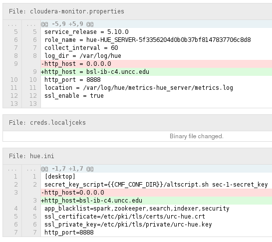

Interesting that you should mention "Bind Hue Server to Wildcard Address". I unchecked that in my Hue configuration, restarted, and the problem went away. I waited a while; well past the point in which the error would typically occur, and figured that it was not going to surface.
Just as a test, I re-checked "Bind Hue Server to Wildcard Address", restarted Hue, and the problem came back.
Just thought I'd add this info to the thread.

No, actually that is *not* the case. My screenshots are from when the "Bind Hue Server to Wildcard Address" was still checked. The reason my http_host in Hue shows the actual server name is because of a setting I had from  @mbigelow's first message: "In the same safety valve, Hue Server Advanced Configuration Snippet (Safety Valve) for hue_safety_valve_server.ini, added http_host under the desktop section.."
So I still had the above change in my Hue Server Advanced Configuration Snippet (Safety Valve) for hue_safety_valve_server.ini file, which made my screenshot look the way it did. If I was not supposed to have that setting still set, I apologize.
One thing I noticed when I unchecked the Wildcard setting is that there were 2 files that shows differences: hue.ini and cloudera-monitor.properties (well 3 if you count the binary file, creds.localjceks):
I suspect the update to cloudera-monitor.properties is affecting the way the CM agent is comminucating with Hue's web server, because when defined the host in the hue_safety_valve_server.ini, CM still exhibited the error, even though according to Hue, my http_host was bsl-ib-c4.uncc.edu. But when I uncheck the Bind to Wildcard setting, http_host was changed for both Hue and CM.

Indeed, the cloudera-monitor.properties includes the configuration.  Hadn't considered it before you brought that up, but since the agent pulls from that file for its configuration, after you have started Hue, you can edit that file and set the "http_host" to what you want.  A restart of the Cloudera Manager agent on the Hue host would pick up your changes when it initializes the monitor.
Setting http_host will not impact this issue as Cloudera Manager sets its own host to use for Hue monitoring.
I've opened a Jira internally here with the CM team to assess how to fix this long-term.
For now, we need to make sure the "allowed_hosts" workaround is working or, if you are OK with disabling the Bind Hue Server to Wildcard Address setting so that Hue listens on a specifc hostname, then we can just go with that as another workaround.
