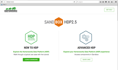

Hi @Manish,
You cannot run the ambari-server setup command on the Hortonworks Sandbox. It's already been completed for you. Once the Sandbox is running, go to http://127.0.0.1:8888/ to get to the welcome page and to enable your access to the Ambari UI. See blow:
Then click on Quick Links on the botton right to get the Ambari access instructions:
