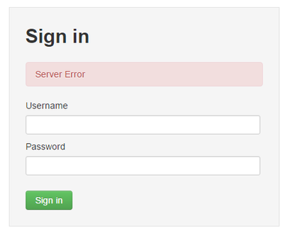

Hello every body
I start with the VM Sandbox and I could not log in in the Abari
netstat -taupen |grep 8080
tcp 0 0 :::18080 :::* LISTEN 513 65820 2221/java
tcp 0 0 :::8080 :::* LISTEN 0 162604 20044/java
[root@sandbox ~]#
So that looks god for me
Then I look at the server log and I find that!
I hope that someone could help me bat I had no idea wat I should do as next!
I also restart the Amari service twice, but the same ;-(
tail /var/log/ambari-server/ambari-server.log
aused by: org.postgresql.util.PSQLException: ERROR: could not read block 0 of relation base/16384/2704: read only 0 of 8192 bytes
