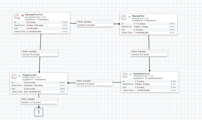

The GenerateFlwoFile has json content and an attribute flowfile_id with value 123

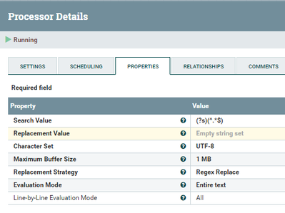

In the ReplaceText I replace everything with empty string:
In the UpdateAttribute Im adding new Attribute new_attr with value of 555

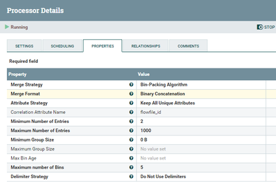

The MergeConent is configured as follows:
I'm using flowfile_id as Correlation Attribute Name. Also notice how I set the "Minimum Number of Entries" to 2 so that original flowfile will wait until the second ready.
The result is the original flowfile content with the new added attribute.
