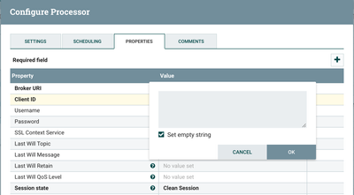

There is the option of setting Client ID as empty string in the processor as shown below.

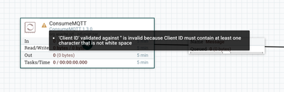

But after applying these settings I don't get the option of starting the processor it gives me a validation error as below
I need my Client ID to be empty because of some connection issues.

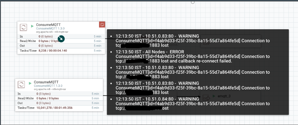

I have attached the connection error we are receiving from the EMQTT.
Technically speaking, although it says there is connection error, it is able to connect randomly, but it drastically replicates the messages when in a Nifi Cluster mode. (e.g. We published 10 messages, we got around 60 messages at the consumer). When we changed it to a Nifi Standalone mode ( for the same 10 messages, we got 10 messages at the consumer).
