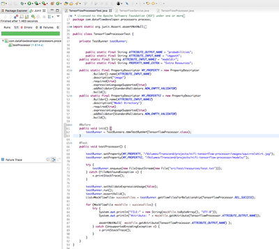

TensorFlow has released a Java API (https://www.tensorflow.org/install/install_java), so I decided to write a quick custom processor to run TensorFlow Inception v3.

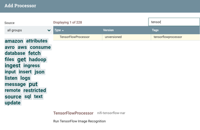

It's easy to add the new processor NiFi. First build it mvn install (see my build script), then deploy it:
cp nifi-tensorflow-nar/target/nifi-tensorflow-nar-1.0.nar /Volumes/Transcend/Apps/nifi-1.2.0/lib
Once you restart NiFi, you can add the TensorFlow Processor.

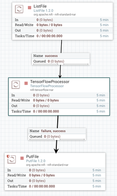

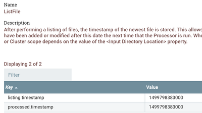

An example flow is to the use the very smart ListFile which will iterate through a list of files and keep track of which the last timestamp of files it accessed. So I point to a directory of files and the NiFi processor gets fed a ton of images to very quickly process. This is much faster than my calling out to a script.

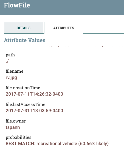

The result of the run is a new attribute, probabilities, which is a string description of what it could be a confidence percentage as text.
This was the guess for the picture of my RV:
