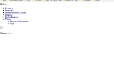

I would like to map the ResourceManager Web UI with Knox.
I've set up the topology like:
<service> <role>YARNUI</role> <url>http://{{rm_host}}:8088/</url> </service>
<service> <role>HDFSUI</role> <url>http://{{namenode_host}}:50070/</url> </service>
But the browser can't load the .css and .javascript from RM UI. "This page will not function without javascript enabled. Please enable javascript on your browser."
I'm using Google Chrome but there are the same problems with Internet Explorer.
JavaScript is working and RM UI directly is working as well. Developer Tool from Chrome: Failed to load resource: the server responded with a status of 404 (Not Found)
Same Problems with NameNode UI.
Can somebody help me please, or are there known problems?
Thanks, Andreas

I see the same 404s in the gateway-audit.log for example:
access|uri|/gateway/default/hdfs/static/bootstrap-3.0.2/js/bootstrap.min.js|success|Response status: 404

at first, thank you very much for your help!! We have a hardware firewall with DMZ enabled in our cluster. It blocks all ports except 8443 for knox. Do you think this might be a problem?

I did the curl command from 2.) from one of the cluster nodes (internal). I tested it now from my client pc with the following command:
C:\01_Data\curl\src>curl curl -i -k -su <my_user> -X GET "https://<our_knox_host>:8443/gateway/default/static/bootstrap-3.0.2/js/bootstrap.min.js"
Enter host password for user '<my_user>':
HTTP/1.1 404 Not Found
Date: Fri, 17 Feb 2017 07:01:45 GMT
Set-Cookie: JSESSIONID=174cdd7p72bdupmc98his5fcr;Path=/gateway/default;Secure;HttpOnly
Set-Cookie: rememberMe=deleteMe; Path=/gateway/default; Max-Age=0; Expires=Thu, 16-Feb-2017 07:01:46 GMT
Content-Type: text/html; charset=ISO-8859-1
Cache-Control: must-revalidate,no-cache,no-store
Content-Length: 342
Server: Jetty(9.2.15.v20160210)
<html>
<head>
<meta http-equiv="Content-Type" content="text/html; charset=UTF-8"/>
<title>Error 404 Not Found</title>
</head>
<body><h2>HTTP ERROR 404</h2>
<p>Problem accessing /gateway/default/static/bootstrap-3.0.2/js/bootstrap.min.js. Reason:
<pre>    Not Found</pre></p><hr><i><small>Powered by Jetty://</small></i><hr/>
</body>
</html>
The Oozie UI is the only one which is working, Oozie is installed on the same node like the our knox gateway. Maybe there is a problem by accessing the NameNode host or Ranger host from the knox gateway (knox host).
