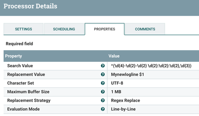

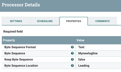

Another option (not as nice as the GrokReader) is to use SplitContent instead of SplitText processor.
So here I use the ReplaceText processor to date string format every log line starts with and prepend to that a unique string that i can use later to split the content.
I then use the SplitText processor to split based on that unique string. This means that any stack trace that follows a log line will be captured with the preceding log entry.
After that you can do what you want with the resulting splits. I chose to filter out the splits for ERROR or WARN log lines and auto-terminate everything else.

Your solution works very well. Its not as pretty as GrokReader true, but it is just Splitting the content rather than putting it into attributes or switching the format of the log file to JSON. I have one unusual result. It is putting a newline in between each event. I don't think this is going to be a big issue for us but is there a reason you can think of that it would do that? Is it doing that on yours?

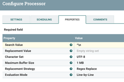

Master Mentor
@Eric Lloyd
Must be a by-product of the splitContent operation. It is reading the last line return before it sees the next bytes sequence. If the blank line becomes an issue, you can remove blank lines using a ReplaceText processor also.
This will replace any line that starts with a line return with nothing.

Thanks thats a solution if the newlines become a problem. You know what else worked for me? I want to put this out there Matt and see if you see any errors in this logic.
Instead of the ReplaceText and all that, I simple added a SplitContent and since I know each event starts with the year, I did a Split Text on:
"(newline)
20"
I realize this solution wouldn't work forever but it would work for the remainder of the century I think. I guess an issue might arise if somehow, in someway, a log produces a newline and then a 20... I am just concerned ReplaceText might be an extrenous time-consuming add-on
