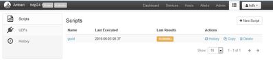

2. When I use Pig view, I add New Script and write a simple code. The task is stuck, it seems not mapreduce not running.

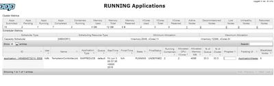

3. I check the yarn log, it is always in RUNNING

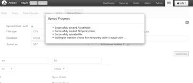

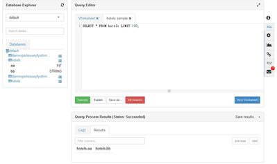

4. I then try to test Hive in Upload Table, I choose one local file to upload to table hotels.
When I submit to upload, it always stop in this message
5. Then I go to hive to see table hotel I just uploaded. It is empty, nothing has been uploaded.

Someone can tell me what's going on? I also try to change some yarn memory setting I google from internet posts.
Unfortunately it doesn't work.

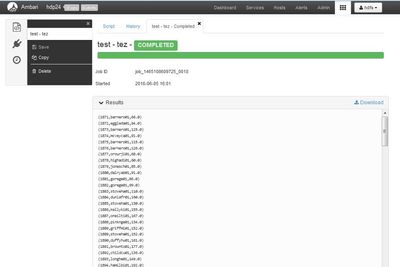

1. Using Pig without Tez => (it is ok)

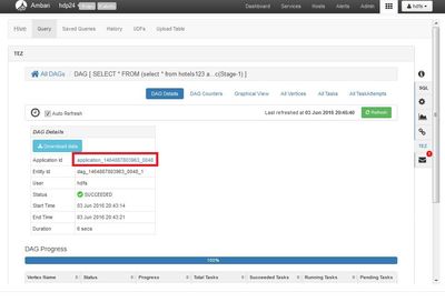

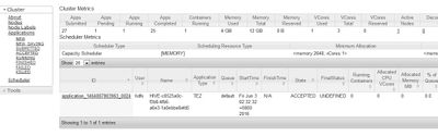

3. Using Hive join table (default using Tez) => (it is finished in Ambari, but RM UI is still in stuck)
Please see the application_1464887803963_0048
4. I use Pig on Tez in terminal (pig -x tez pig.test) => (it is ok)
