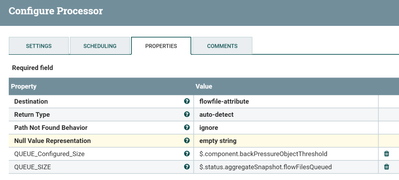

You can extract the queue configurations i.e backPressureDataSizeThreshold (or) backPressureObjectThreshold from json response keep them as attributes by using evaluate json processor.
QUEUE_Configured_Size
$.component.backPressureObjectThreshold
Compare the configured size with how many flowfiles are queued
QUEUE_SIZE
$.status.aggregateSnapshot.flowFilesQueued

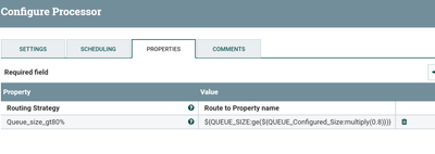

Route on Attribute Configs:-
Queue_size_ge80%
${QUEUE_SIZE:ge(${QUEUE_Configured_Size:multiply(0.8)})}
so we are checking the queue_size(how many flowfiles are queued) greater than equal to queue_configured_size multiply with 0.8(means 80%), if the flowfiles queued are greater than or equal to 80% we are going to keep those flowfiles into Queue_size_ge80% relation.
Example:-
if my queue configured to have 10 objects then if the queued flowfiles are greater than equal to 8 then the ff routes to Queue_size_ge80% property.

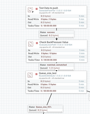

Hi @@dhieru singh
Thank you for the post , but I am unable to get the values of
  1. $.component.backPressureObjectThreshold
  2. $.status.aggregateSnapshot.flowFilesQueued after processing the EvaluateJsonPath.107814-backpressure.png
