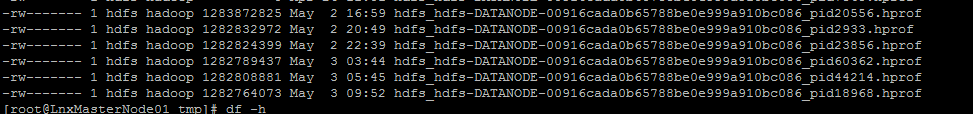

Hi All,
I have 3 node cluster running on CentOS 6.7 having cloudera 5.9.
Namenode has been facing issue of .hprof files in /tmp directory leading to 100% disk usage on / mount. The owner of these files are hdfs:hadoop.
undefined
I know hprof is created when we have a heap dump of the process at the time of the failure. This is typically seen in scenarios with "java.lang.OutOfMemoryError".
Hence I increased the RAM of my NN to 112GB from 56GB.
My configs are:
yarn.nodemanager.resource.memory-mb - 12GB
yarn.scheduler.maximum-allocation-mb - 16GB
mapreduce.map.memory.mb - 4GB
mapreduce.reduce.memory.mb - 4GB
mapreduce.map.java.opts.max.heap - 3GB
mapreduce.reduce.java.opts.max.heap - 3GB
namenode_java_heapsize - 6GB
secondarynamenode_java_heapsize - 6GB
dfs_datanode_max_locked_memory - 3GB
dfs blocksize - 128 MB
The datanode log on NN has below error but they are also present on other DN (on all 3 nodes basically):
2017-05-03 10:03:17,914 ERROR org.apache.hadoop.hdfs.server.datanode.DataNode: DataNode{data=FSDataset{dirpath='[/bigdata/dfs/dn/current]'}, localName='XXXX.azure.com:50010', datanodeUuid='4ea75665-b223-4456-9308-1defcad54c89', xmitsInProgress=0}:Exception transfering block BP-939287337-X.X.X.4-148408516
3925:blk_1077604623_3864267 to mirror X.X.X.5:50010: java.net.SocketTimeoutException: 65000 millis timeout while waiting for channel to be ready for read. ch : java.ni
o.channels.SocketChannel[connected local=/X.X.X.4:43801 remote=X.X.X.5:50010]
2017-05-03 10:03:17,922 ERROR org.apache.hadoop.hdfs.server.datanode.DataNode: XXXX.azure.com:50010:DataXceiver error processing WRITE_BLO
CK operation  src: /X.X.X.4:53902 dst: /X.X.X.4:50010
java.net.SocketTimeoutException: 65000 millis timeout while waiting for channel to be ready for read. ch : java.nio.channels.SocketChannel[connected local=/X.X.X.4:438
01 remote=/X.X.X.5:50010]
        at org.apache.hadoop.net.SocketIOWithTimeout.doIO(SocketIOWithTimeout.java:164)
        at org.apache.hadoop.net.SocketInputStream.read(SocketInputStream.java:161)
        at org.apache.hadoop.net.SocketInputStream.read(SocketInputStream.java:131)
        at org.apache.hadoop.net.SocketInputStream.read(SocketInputStream.java:118)
        at java.io.FilterInputStream.read(FilterInputStream.java:83)
        at org.apache.hadoop.hdfs.protocolPB.PBHelper.vintPrefixed(PBHelper.java:2241)
        at org.apache.hadoop.hdfs.server.datanode.DataXceiver.writeBlock(DataXceiver.java:743)
        at org.apache.hadoop.hdfs.protocol.datatransfer.Receiver.opWriteBlock(Receiver.java:169)
        at org.apache.hadoop.hdfs.protocol.datatransfer.Receiver.processOp(Receiver.java:106)
        at org.apache.hadoop.hdfs.server.datanode.DataXceiver.run(DataXceiver.java:246)
        at java.lang.Thread.run(Thread.java:745)
2017-05-03 10:04:52,371 ERROR org.apache.hadoop.hdfs.server.datanode.DataNode: XXXX.azure.com:50010:DataXceiver error processing WRITE_BLO
CK operation  src: /X.X.X.4:54258 dst: /X.X.X.4:50010
java.io.IOException: Premature EOF from inputStream
        at org.apache.hadoop.io.IOUtils.readFully(IOUtils.java:201)
        at org.apache.hadoop.hdfs.protocol.datatransfer.PacketReceiver.doReadFully(PacketReceiver.java:213)
        at org.apache.hadoop.hdfs.protocol.datatransfer.PacketReceiver.doRead(PacketReceiver.java:134)
        at org.apache.hadoop.hdfs.protocol.datatransfer.PacketReceiver.receiveNextPacket(PacketReceiver.java:109)
        at org.apache.hadoop.hdfs.server.datanode.BlockReceiver.receivePacket(BlockReceiver.java:500)
        at org.apache.hadoop.hdfs.server.datanode.BlockReceiver.receiveBlock(BlockReceiver.java:896)
This log is getting such errors even during night time or early morning when nothing is running.
My cluster is used to getting webpage info using wget and then processing the data using SparkR.
Apart from this, I am also getting Block count more than threshold, for which I have another thread. http://community.cloudera.com/t5/Storage-Random-Access-HDFS/Datanodes-report-block-count-more-than-t...
Please help!.
Cluster configs(after recent upgrades) -
NN: RAM- 112GB, Core 16, Disk : 500GB
DN1: RAM- 56GB, Core 8, Disk: 400GB
DN2: RAM- 28GB, Core 4, Disk: 400GB
Thanks,
Shilpa

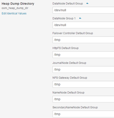

Hi, as a workaround you could prevent the generation of the hprof files by setting the jvm option HeapDumpPath to /dev/null instead of /tmp. This will not resolve the root cause obviously.
Rising Star
Hmm.. actually I thought about it once but didnt do it. But till I find a resolution i need a workaround. So i have changed the HeapDump Path to /dev/null but only for Datanodes.
Thanks @Ward Bekker 🙂
