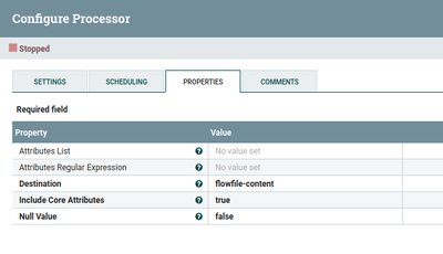

In the UpdateAttribute I set content to:
${innhold:base64Decode()}
and in the AttributesToJson I did this:
The result is a json-fil with one attribute "content", and this attribute contains the whole XML-file.
Where did I go wrong here?
So the flow now looks like this:
Thanks,
bjornmy
