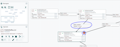

In Apache NiFi, the flow file got stuck permanently in queue when the downstream processor has some errors.
I am looking to route the flow file to failure relationship so that I can handle the failure and extract the failure log. But in some cases the flow file got stuck in queue permanently which makes routing to failure relationship impossible.
Is there a way to resolve the issue of flow file getting stuck? If not, is there a way to get notified that a particular flow file waits in which queue and which downstream processor in the processor group has error, so that I can track the failure?

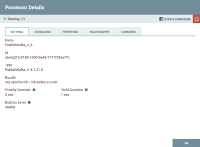

Downstream processor's settings and configuration:
Note: Nifi is the part of the application we use to process files. We are looking for handling failure in Nifi processors without explicitly visiting NiFi UI every time (Getting to know about failures in NiFi processors from the system instead of visiting NiFi UI ). In the case mentioned above, it is impossible to route to failure relationship.

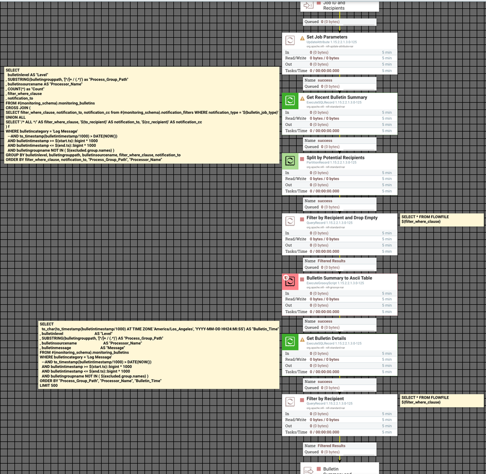

Hi Kellerj. Thank you for the reply. I will try this approach for my case. Can you please send the sample template for the flow you mentioned?
Contributor
Sure.  I had to make some extract it from a larger PG and make some adjustments due to key code being in a parameter.  But the remainder of the parameters are really placeholders for your environment information.  The main complication might be that I used a few external controller services that you will have to replace.  But their names in the externalControllerServices JSON should help you replace them.
