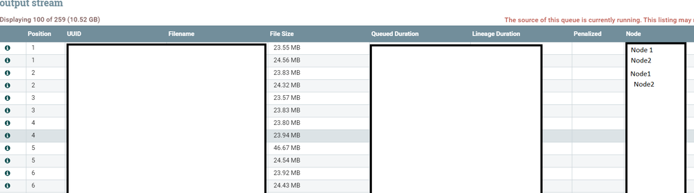

  • putHDFS-To put data into HDFSMy problem is after ExecuteStreamcommand Processor is triggered in the queue I could see two positions with same valuequeue.png
    For every half hour I should get 1 output file but I could see 2 files as output. NIFi is running on 3 nodes, and list queue on 2 nodes. Files running on node1 is merged as 1 file and files running on node 2 is fetched as 2nd file so I'm getting 2 files. Could you please let me know how to get one file Thank you in advance for your help

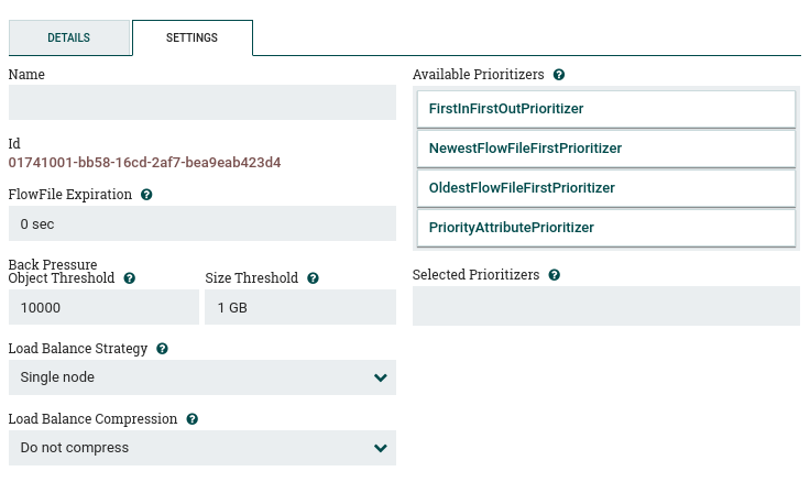

Consider the MergeContent processor in the picture as your MergeContent processor.
Configure the queue(here, 'success') that acts as the upstream queue for your MergeContent processor.
Select the load balance strategy as Single node, then you will get all the files as input to only one of the nodes.

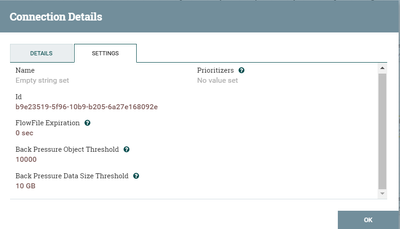

Thank you  @PVVK  for your solution, I am unable to view  the option load strategy in the queue before the mergecontent processor So I have done this. Previously the fetchSFTP was set to execute on all nodes and I changed the option to execute on Primary node. As a result I am getting single file now. Please correct if if I am wrong

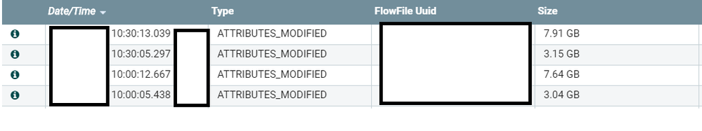

Also There is a delay while data is loading into HDFS using PUTHDFS Processor.After compression, while there is a change in size from MB to GB, it is being loaded after 1 hour.
Please find the screenshot below for your reference
