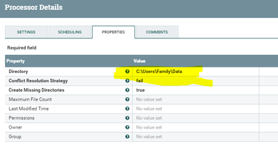

Use cmd terminal to go to data directory and mention the full path in directory value.
You need to mention path as below if you want to see those files in your data directory
C:\Users\<username>\Data
Go to cd c:\Data directory using command prompt(cmd) to check the already written files from NiFi
Example:-
If i want to write any file from NiFi to Downloads directory i need to mention below path in PutFile directory value
C:\Users\Shu\Downloads
if i use C:\Downloads we are writing the file into C:\Downloads not to C:\Users\Shu\Downloads, use cmd terminal(cd C:\Downloads) to see the files.

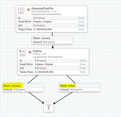

Check once the permissions because there needs to be 10.1 MB in and also Out.
For debug purpose use funnel and connect success and failure relationships from PutFile processor.
Sample Flow:
Check where the files are routing to success or failure relationships, if the files are routing to failure relation then go to nifi-app.log to find the root cause.

Interesting, the success route has 9 in the queue now and 1.45 MB. Nothing going the failure route. Is there other configuration need for the funnel?

Funnel is just for testing out where the flowfiles are routing to i.e is they are going to Success or Failure relationship, there is no other configs needed for funnel.
Now 9 flowfiles are routed to Success relationship(i.e no permission issues encountered), now check the files in the directory(c:\data).
If you are still not able to see the files in the directory share PutFile processor configs and list of files in data directory using ui (or) cmd screenshots.
