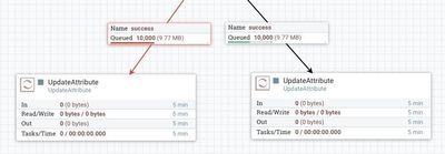

There isn't a way that I know of to send alerts based on the threshold. The threshold is used by NiFi to trigger back-pressure, which means when the threshold is reached the components right before the queue will no longer be triggered to run anymore until the queue goes below the threshold. In the next Apache NiFi release (1.1) there will be a color indicator as to whether back-pressure is occurring or not:
