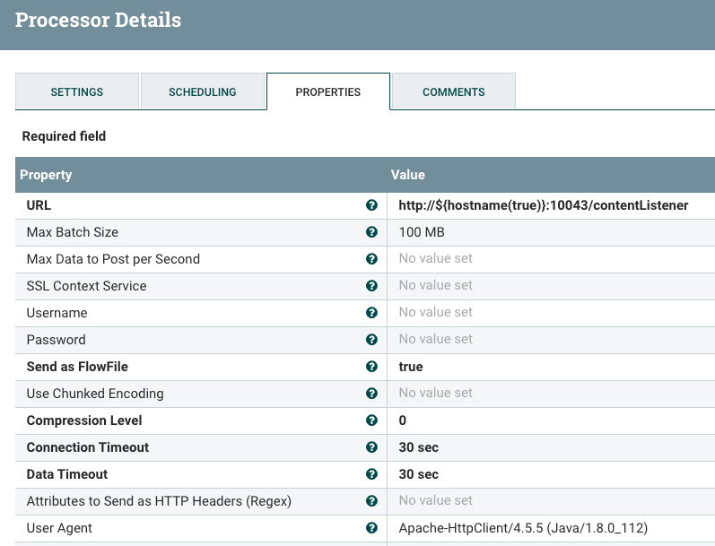

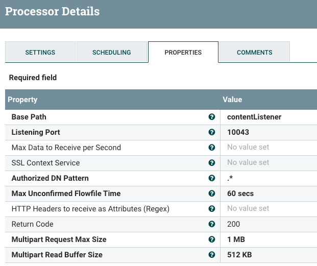

However, we can assume that the NiFi node that is processing the FlowFile must be up or the FlowFile would not be getting processed. So you could just configure your postHTTP processor to use a dynamic URL based on a NiFi Expression Language statement that just use the hostname of the node on which the FlowFile is already being processed.
Example PostHTTP processor configuration:
Example ListenHTTP processor configuration:
The above allows you to send FlowFiles from a postHTTP to a ListenHTTP on the same node.
Note: Understand that you are adding additional read and writes to the content repository and sending data across the network which will add latency versus just routing the same FlowFile continuously within the canvas from one dataflow to another via directly connected dataflows.
