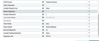

The CSVRecordSetWriter is configured like this:

I have eventually solved the issue. The Writter property "Schema Access Strategy" was misconfigured. It must be set to "Use 'Schema Text' Property" to really apply the given schema .
