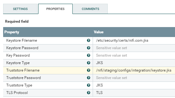

I am invoking a REST API from Nifi using InvokeHTTP processor and wanted to enable mutual certificate authentication between client (nifi) and server.
I enabled StandardRestrictedSSLContextService (controller service) as mentioned in the below screenshot and getting below exception:

Screenshot:
Am I missing anything, kindly please explain how to enable mutual certificate based authentication?

As mentioned in the below screenshot, I have added client cert (.jks) in keystore and server cert (.jks) in truststore. Server is expecting a client cert as part of request but when I make a rest call, client certificate is going in the request.
Here is the command that I used to generate a .jks file on top of client certificate:
keytool -importkeystore -srckeystore nifi.com.pfx -srcstoretype pkcs12 -destkeystore nifi.com.jks -deststoretype jks -srckeypass 'abcxyz' -alias data-nifi-cd
@MattWho

Unfortunately with the information you have shared, it is not possible for me to validate what the issue is here.
I would need to output from the openssl commands i shared earlier to help.
openssl s_client -connect <server hostname>:<server port>
Also the verbose listing of both your keystore and truststore files would be needed:
keytool -v -list -keystore keystore.jks
keytool -v -list -keystore nifi.com.jks
The target server is what decides if connection is going to use mutual auth or not.  The invokeHTTP is the client side of this connection and only provides what the server asks for in the server hello response.
It is possible also in that server hello response that the server wants a client certificate; however, the list of CAs sent in that server hello response does not contain a CA capable of trusting your clientAuth PrivateKeyEntry in your nifi.com.jks.  In that case client would not send the client certificate since server is incapable of trusting it.
