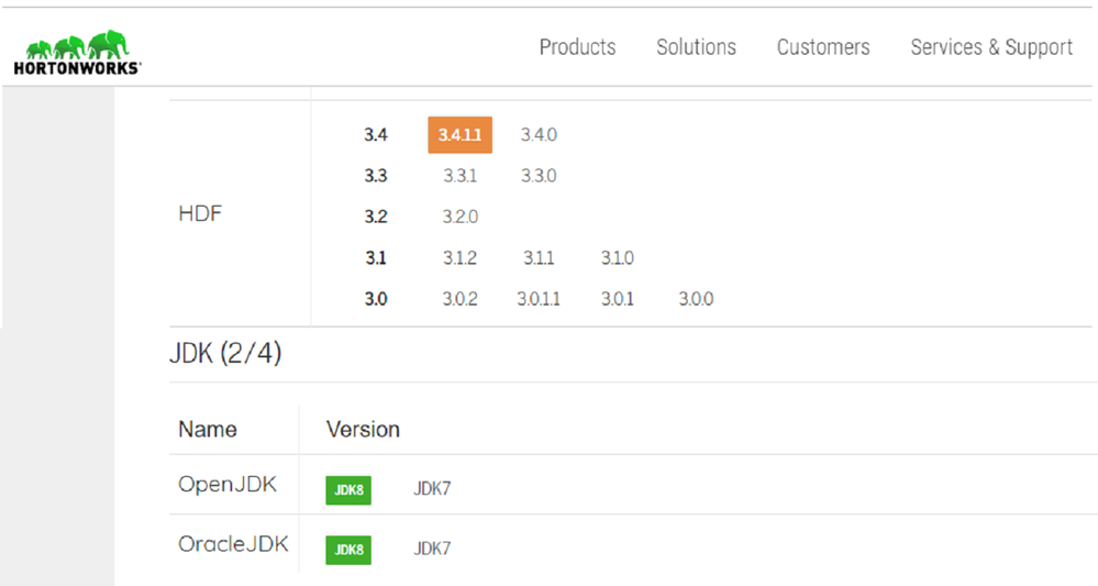

The simplest answer I can give you if compatibility! HDF/HDP/HCP are packaged applications that have undergone rigorous unitary tests are supposed to "work as" that explains why you cannot upgrade ONLY a component and upgrade minor or Major released go through a battery of test and QA to ensure all the components work properly.
In your case Java 7 and 8 are to date the recommended versions the latter being the most preferred. From the matrix link https://supportmatrix.hortonworks.com/ I filtered out the latest version of HDF and No HDP/HDF product has been certified against Java 11 as of now, that could change in the near future but it won't definitely be with your current version of Nifi .
So the above could explain your dilemma. Do you have a special use case as to why you want to use Java 11? I am not sure whether Cloudera offers a workaround but if you bought support from Cloudera then you can open a ticket.
