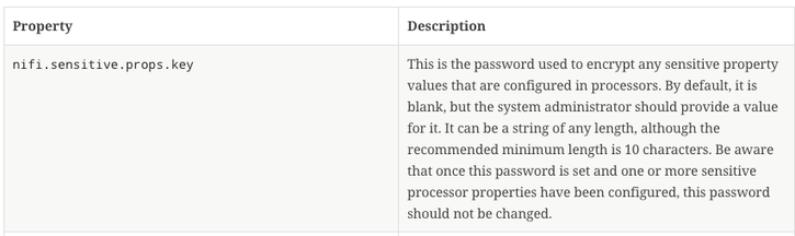

Master Mentor
@NaveedButt
The exception you shared is complaining about the nifi.sensitive.props.key property not being set in the nifi.properties file at startup:
This pops key value is used to encrypt all sensitive component properties created in the flow.json.gz as you build your dataflows via the NiFi canvas.
If you have not built any dataflows that utilize sensitive properties in the component configurations, you can just set some value and start your NiFi.
If you have already existing dataflows on your NiFi canvas containing sensitive values set (passwords) in the configurtion(s), you'll need to retrieve the exact password from the original nifi.properties and use that.  If original props key is not set, NiFi will fail to start when it tries to load the flow.json.gz since it will not be able to decrypt those passwords using the new props key.
If you get stuck, you can carefully manually edit the flow.json.gz and remove all "enc{.....}" values.  This will allow you to start your NiFi using a new sensitive props key value; however, all your configured passwords will be cleared and you will need to enter them again into your various component configurations.

Master Mentor
@NaveedButt
