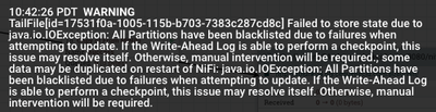

We were running Nifi on a server that reached maximum storage usage (100%) and it seems to have corrupted the Nifi Installation.
I initially got the error shown in the screenshot so I decided to restart Nifi and now it wont start with these errors:

You don't have to uninstall NiFi to start clean. Just clean out all the directories under the content, flowfile, provenance repositories and you should be good to go.
When you ran out of disk space it corrupted the flowfile repository, which is how NiFi knows the status of the flow files in the graph.
If possible, I would recommend at a minimum of moving the flowfile repository to it's own disk partition.
