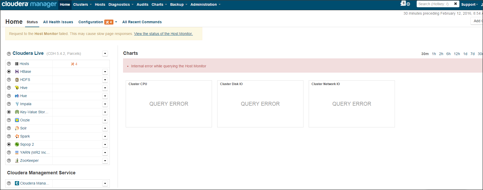

Went against the default Cloudera Manager port:
That looks to be up to although I have not worked with it before.
Re: Not getting e-mails when starting Cloudera Live stack in Amazon.
Master Collaborator
So if you restarted your instances before the deployment finished, the dpeloyment will not have finished. You may be missing datasets or some configuration in your cluster. If you didn't already read it, read the "Stopping and Starting Instances" section of the documentation, as there are some other caveats you should be aware of:
http://www.cloudera.com/get-started/cloudera-live/aws-documentation.html
