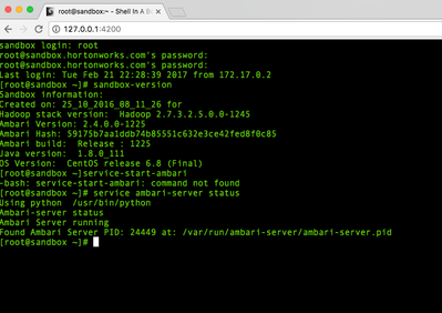

The sandbox-version command should definitely work if you are SSHd into the correct environment using port 2222 and logged in as root. I think your command to start Ambari is invalid though, I believe it should be as follows:
service ambari-server [status|start|stop|restart]
The other way in is to use the web SSH tool: http://127.0.0.1:4200/ I find this a bit more convenient than using the direct access on VirtualBox. If you can login there with root, you can try changing the Ambari admin password again: ambari-admin-password-reset
Once you change the Ambari admin password, try logging in as the admin via: http://127.0.0.1:8080
Otherwise you always have the option of deleting the Virtual Box VM and re-importing the appliance to start over again
