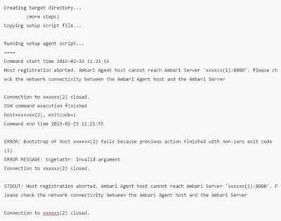

I noticed I hadn't set up passwordless ssh between the two I am setting up and that helped but now there's another error. The servers I have are not configured for DNS (will be soon) and are only accessible via IP address. Would this be a factor during setup?
Below xxxxxx(#) represents the FQDN and the specific server its referencing in parentheses
Re: Problem during Ambari Confirm Hosts
@Mark Thorson Yes, please do not use IP for the host config. You can levergae /etc/hosts but I suggest to wait for the DNS
