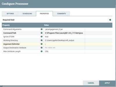

Yes , I figured out how to run a jar in nifi using ExectureStreamCommand processor.
I am having a piece of java code , along with a jar file , by creating manifest file . I created another Master Jar file , which need to be run in nifi environment to get data. refer :- http://stackoverflow.com/questions/8890747/creating-a-jar-file-which-contains-other-library-files http://stackoverflow.com/questions/1082580/how-to-build-jars-from-intellij-properly Now once we have our JAR ready , we just need to give java -jar <jarfilename>.jar conventionally . In NIFI , we need to use ExectureStreamCommand processor . to trigger the action , step 1) create a GenerateFlowFile 2) In ExectureStreamCommand processor , update the properties as follows. ( here my jar name is engagement_3.jar) and we all know that the command to run java jar is java -jar <jarfilename>.jar but we need to omit "java" and give rest of command , but the delimiter is ";" . So the command is -jar;engagement_3.jar or -jar;<jarfilename>.jar In COMMAND PATH, specify the system environment path , <JAVA_HOME>\bin\java BUT NOT <JAVA_HOME>\bin\java.exe.
Working directory is the location where your jar is hosted in local.
Rest of the properties within ExectureStreamCommand processor are as follows.
