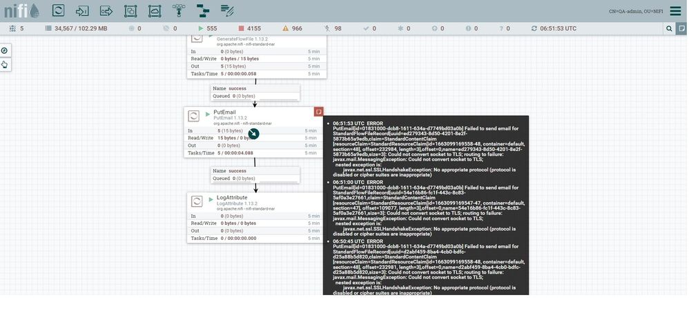

I have been trying to send an email via NiFi using PutEmail processor with Gmail/Outlook both and getting same exception in both of the configuration as
PutEmail[id=3611dcb8-0183-1000-8a1d-df8f12f92438] Failed to send email for StandardFlowFileRecord[uuid=017c80a8-fad0-493b-a427-fa72b9a530c7,claim=StandardContentClaim [resourceClaim=StandardResourceClaim[id=1663081396353-45, container=default, section=45], offset=521106, length=538],offset=0,name=f37f23a1-e328-4eff-bb30-6f125369ebf7,size=538]: Could not convert socket to TLS; routing to failure: javax.mail.MessagingException: Could not convert socket to TLS;
  nested exception is:
	javax.net.ssl.SSLHandshakeException: No appropriate protocol (protocol is disabled or cipher suites are inappropriate)

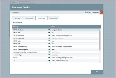

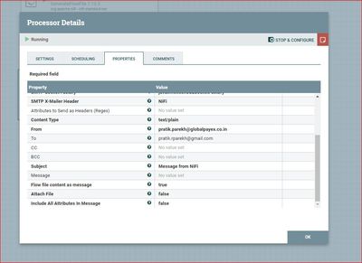

The configuration is set as below :
Current NiFi version is  : 1.13.2
